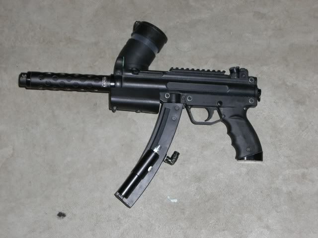

Here's how it is currently.
Here's what I'd like to do.. Get the Stab in the mag.. the mag seems to have slots, and a hole in the bottom for velocity adjustment. But with macro fittings, the inline stab will not work..
I was using the mag as a screw driver holder for my e-grip, and I had the inline stab on the grip so I could take the dog leg off for CQB. I have seen the stab I have mounted on the dogleg I have, and I would go that route, but again even with the air through DL, if I have the stab in the mag, I can take the DL off, and just change some macro lines around.. With the stab in the stock I am stuck using it that way.

The direct stab is taller than the inline, with the inlet on the side.. Looks like it would work.. Then it's be a straight shot to the tombstone. the reason I ask is, I would offer my line new inline stab, woth the gauge, and ring mount for a direct stab of the high psi internals.

It won't fit up there, the angle in the mag is too heavy in the beginning, My only issue is that I'm going to have to sell my stab, and order a used, or a new direct stab just to see if it works.. If the direct stab doesnt fit, then I'm screwed.

ah man, that tombstone block is going to hold me back.. plus the new direct stabs are different.. oh well. It was worth asking. I loke the look of the angled male on that though.. You know I bought the mag to house the stab, and threw it on even though it wouldnt work.. I have learned to like it because it is really long, and I like to go prone a lot.. That mag makes a great uni-pod for getting the marker up, and allowing me to aim it and pivot it, lol, so I've kept in on there.
The tombstone block mine came with is just a 1/8th npt out of the bottom.
