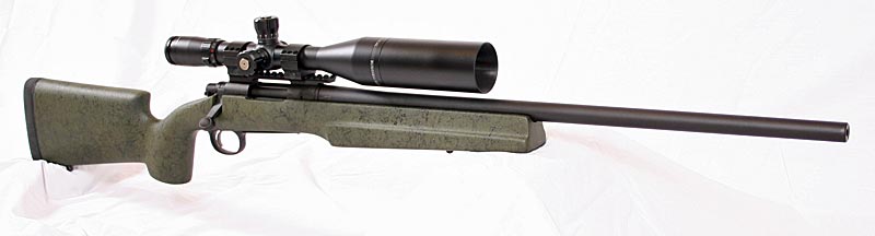

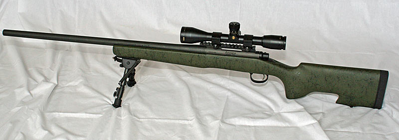

i was REALLY looking at a Bell and Carlson stock i found, its the one on the Remington XCR tactical rifle. I have yet to find it on their site though.... shame. i loved the way it looked.
i put i liked wood stocks? haha, idr it... ive used synthetics whenever i could.

My mistake, I took "cheap plastics" as an aversion to synthetic. If you like synthetic, then Choate or B&C are great. There are nicer options, but those are correspondingly more expensive, and I'm sure you're not looking for a $5000 rifle.
Oh, I will say, look at Accuracy International's Remi 700 options. Stocks and detachable box magazines are my personal favorites.

Bell & Carlson Light Tactical Medalist Synthetic Stock
http://www.midwayusa.com/viewproduct/?prod..._campaign=10636
This something like the stock you were looking for? They also offer a version of this with a vertical grip, the Bell & Carlson Full Tactical Medalist Synthetic Stock.
Also, any updates?

Pistolwhipped, i had looked at those. my problem with the light tactical is that it isnt offered in long action. my project gun is hopefully going to be in .300 Win Mag, which requires a long action. The other one, the adjustable one, was one i was really considering.
