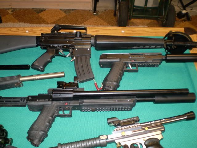

But, you can make your Spyder look tactical. Mine:
It's up top. Yeah, Vietnam era M-16 (still needs the correct era magazine to complete the look, but you get the feel for it). Built from a MR-1.

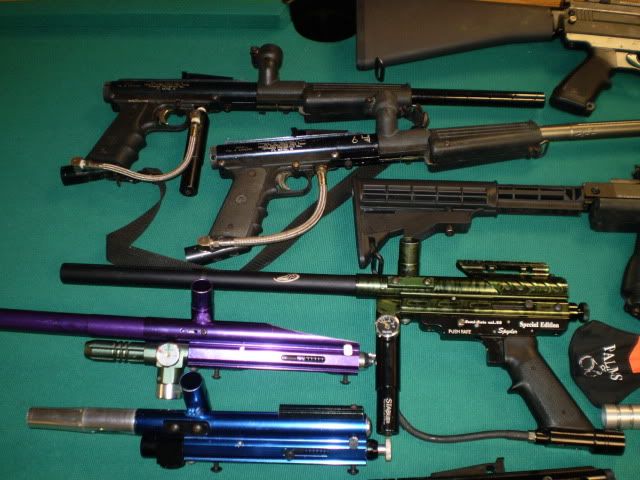

My SE (trigger not installed currently, doing some work on it):
