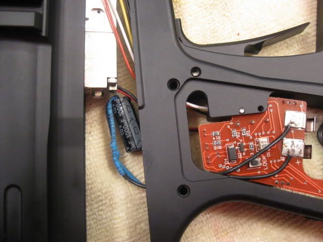

Ok Droop, here is the real scoop.
First, the Drone can take the cyborg RX board (which has the OLED display) without modification to the Drone (except for the grip window). The RX board, however, needs a capacitor installed to work with the Drone. Currently, Macdev will do this special order on a new gun. Krazy8 or myself can hook you up.
The standard RX software loses the cool fire mode shift-on-the-fly that the drone has, but adds more fire modes and that nifty display. So what if you could have it all? Tadao can reflash the modified Drone board with the RX Yakuza software. It has the useful USB interface and software, customizable boot screen ( team logo and your name at bootup maybe?), it brings back the response trigger and all the tourny modes, AND they are selectable on the fly through the back button. Needless to say, my board will be going to Tadao soon.
stock board (note capacitor where OLED should be)
RX board
RX board capacitor
This post has been edited by Boomer14: 09 October 2009 - 06:16 PM

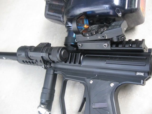

On a different note, I tried out a sight on the Drone yesterday. It is surprisingly fun on 3-shot burst. Just center sight ring on target, pull trigger, and three balls hit in the ring. For me, the natural point of aim for my Drone and stock combo is such that I do not need to take the time to use a sight. But for those who prefer to long ball one at a time, a sight can be mounted effectively on the Drone with a 45 offset.

How did you go "Zeroing your sight" with the 45 deg angle? Did you max out your windage and elevation settings at all?
Did you try mounting the sight on the right? I'm just curious if you're "Left eyed" but "right handed"?
I have a drone also and I've been wondering how I will set it up....
#53 User is offline   Boomer14
  • Irregulators Member
  • Posts: 55
  • Joined: 18-February 09
  • Location:Northeast Oregon
  • Brigade Name:Durty Dan
Posted 20 October 2009 - 06:39 PM
You are astute to notice that the cant makes it more challenging to zero, Zee Shooter. :laugh:
Once you realize that the windage also moves it in elevation, it's not hard to figure out. I had no problem zeroing in about 3 adjustments. If I played more deliberately and actually made myself take one-shot attempts, the sight would work for me- it actually works great on the target range. I zeroed it for about one foot high at 50', and it was right on at about 100'.
I am right eye dominant and right handed, and I was able to use the sight with both eyes open, no problems. Because of the left offset, the sight picture is actually more natural than most sight setups with a mask on. The pictures don't give a real perspective looking down the barrel through the sight. Also not pictured is the T2W stock.
Anywho, welcome to the drone family! :dodgy:
