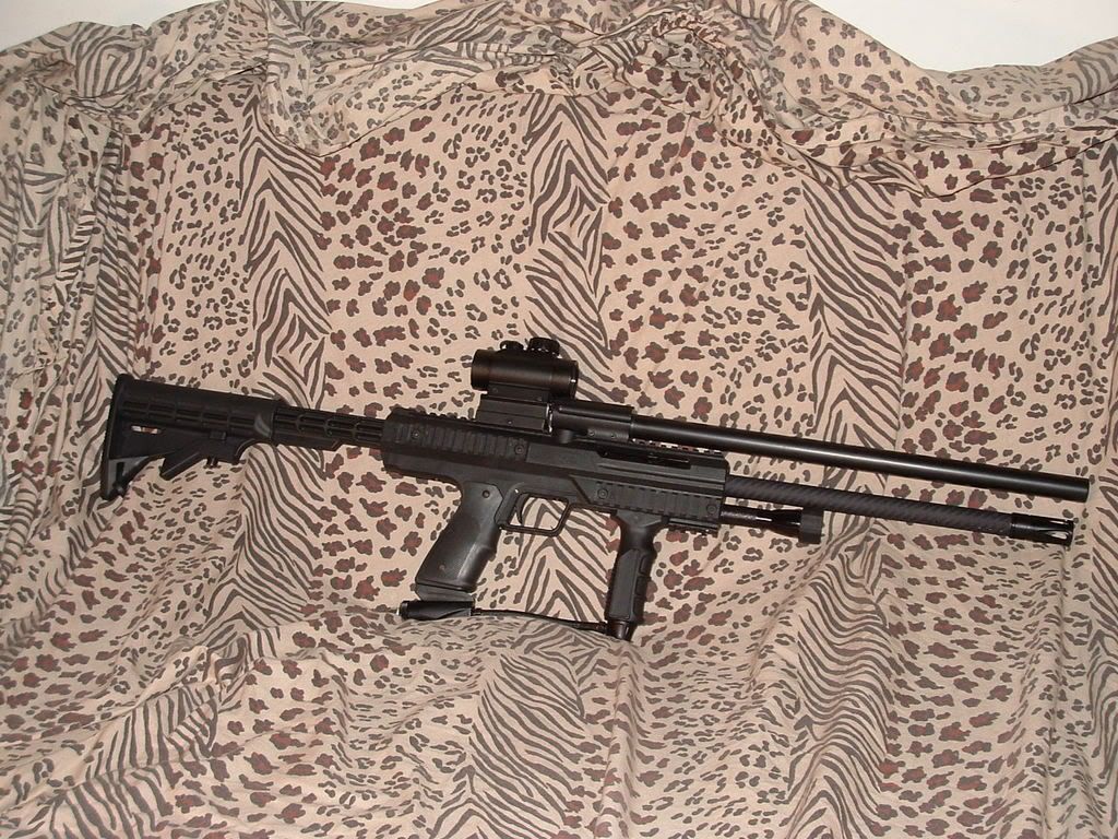

I just received my longbow kit to mod my sp1. I'm going to have to mill down the feedneck about a half inch or so, to get the mag feed system to clear (a permanent change to the body) and then fill down some of the individual weaver rails just a hair for the screw lines to match. It's been done b-e-a-utifully before, check youtube and google for video's, they have some sweet paintjobs on them too. There was some pictures in this forum somewhere as well, but couldn't seem to find them at the moment. That's where I saw them originally, and fell in love with the idea. If I get mine moded soon, I'll post some pics for you and let you know how the process goes. But ya, it's gonna look sick :D

Its doable -
http://www.x7og.net/...p1-longbow.html
