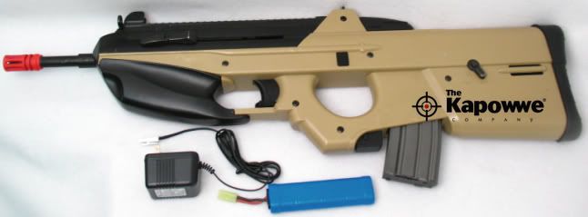

View PostTheDane, on Jul 22 2007, 03:34 AM, said:
you mean like this?
i like the look of that alot. the only tricky part is going to be getting the A-5 grip on there
exactamundo my friend that is an issue in my head right now
eh dont worry i can work around it gut the e grip establish new mouting points in the shell and simply insert
you mean like this?
easyer than looks
i'll take your word for it. but what about where the base of the grip meets the 'mag casing, ya know? thats the part i dont want to screw up

Post icon  Posted 22 July 2007 - 12:47 AM
it will be unharmed hope fully we can keep the mag in place for a super mil sim look
ya know what else would be cool if the weaver flips up to reveille the long bow mag
yeah, but when we replace the grips, we'll need to cut the original grip out leaving the end of the mag's "casing" sticking out like a hook. we'll either have to cut that down too and completely separate the grip from the mag shell, or just find a way to join them again. it would seem the latter would be much harder but i dont really know

Post icon  Posted 22 July 2007 - 12:54 AM
no, the grip will be the grip in the pic,
the e grip wont be showing
the outside of the e grip will be removed
the board, solinoid,
and batteries will be internal
there will be enough space to fit it

Posted 22 July 2007 - 12:58 AM
no no no. we dont actually use the e-grip at all. we want the e-grip's FRAME and only the frame because of the way it's molded to hold the re-routed micro switch
we want the trigger too of course. but nothing else
This post has been edited by TheDane: 22 July 2007 - 01:01 AM
aaaahhh i see now as for the mag Question you can trim the sharp part and make it as if it wasnt a thumb hole stock

Posted 22 July 2007 - 01:02 AM
thats what i was wondering about. so now back to how the hell are we going to get the grips switched effectively? seeing as the body of the gun is too fat, we cant slide it on like the A-5, but rather slide it IN
This post has been edited by TheDane: 22 July 2007 - 01:03 AM

Post icon  Posted 22 July 2007 - 01:07 AM
just like the A5 those 2 pins that hold it on
i can mold it to the right size on the shell
just use the trigger to establish the connection and run the wires to the back

Posted 22 July 2007 - 01:11 AM
there's no reason to get that messy with the wires. i've already inverted the switch to comply with the grips functionality, and the switch fits neatly under the trigger. then we just run the wires back. without the switch we would f-up the way the board works.

Post icon  Posted 22 July 2007 - 01:13 AM
larger pins thanso it goes though the shell then e grip than out
cut a hole in the side for safty switch

Posted 22 July 2007 - 01:17 AM
fortunately for us, those longer pins are quite common. with the safety, we should just cut out a little "arch" section right over top of where the safety is. completely free it up so it's not difficult to push (especially when you have gloves on)
perfect

Posted 22 July 2007 - 01:20 AM
right. it's settled then. we both know what we're gonna do, and both have a plan of action... im going to bed now. keep in touch with your progress
