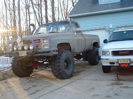

i lifted my buds 1998 s10 blazer
has 2" body lift (already had that)
but i added a 6" suspension lift
my truck has been a project in the works...
350 sb from a 1991 caprice police car with roller motor
comp cams extreme 4x4 roller cam (.457" lift)
1996 tahoe vortec heads
vortec dual plane intake
msd 6al with built in rev limiter and timing control
dana 60 front and 14bolt rear both locked with detroits and 4.56 gears (factory gears!!!!!)
smc 465 trans (granny gear)
np205 xfer case
1978 chevy 3/4 ton
patriot extreme 15k winch in back between frame rails
6" superlift springs front and 12" rear 56" leafs with factory block removed for total of 9" rear lift)
1" ord zero rate up front for total of 7" front
ord xover steering
1976 caddy eldorado caliper swap in rear
40" ground hawgs
bushwacker cutout fender flares
arb snorkel
im currently rewiring the entire truck.. taking me 2 years but should be done soon...

Fabfour Prerunner
Not a warn bumper, but, similar to what I want, and you're right, I'll need to do some fabing to it.
@ Tele, I'm in Washington State. I'd end up owing you alot of beer for coming out to help me fix this thing up LOL However, I will certainly be happy to discuss these things with you.
Regearing the tranny..... I thought that as well, along with speedometer and other semi useful guages that might be off a little due to the tires.
I have actually been looking through Here for some of this. It's a site dedicated to what they term as "Ranger Based Vehicles"
Nice truck BTW B)
