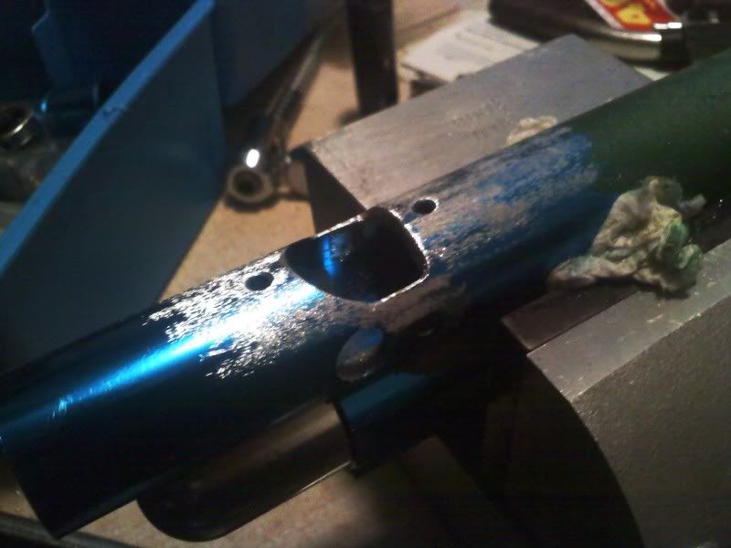

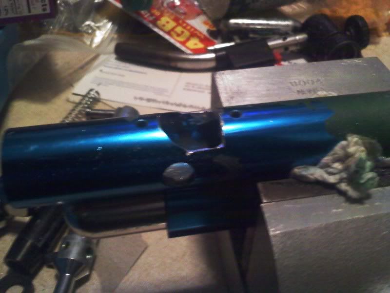

Posted 07 March 2010 - 07:23 AM
Start:
So Far:
Removing the feedneck was easy (2 screws)
Removing the bottom line was easy (4 screws)
Removing the metric to 1/8 adapter from the front block was hard! They use red loctite on the spyder victors, so I had to take a blowtorch to it.
Edit (I kept working):
Dremeling away to let it accept first strike rounds, not hard, but totally time consuming.

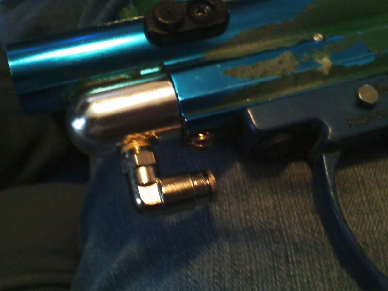

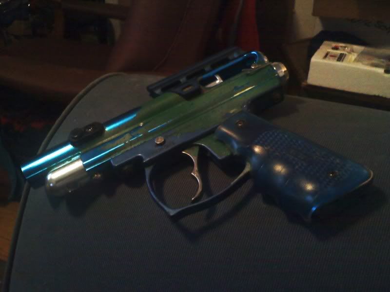

Posted 08 March 2010 - 04:21 PM
This was REALLY hard to do...not...LOL
90* macroline fitting installed in the block. For anyone that was wondering the only metric part on a spyder is the bottomline. Why they switched from standard 1/8 NPT to some metric crap is beyond me... You can put standard fittings into your stock victor 1 block. Though, I had to use a blowtorch to get the 1/8 to metric adapter fitting out (red loctite)
