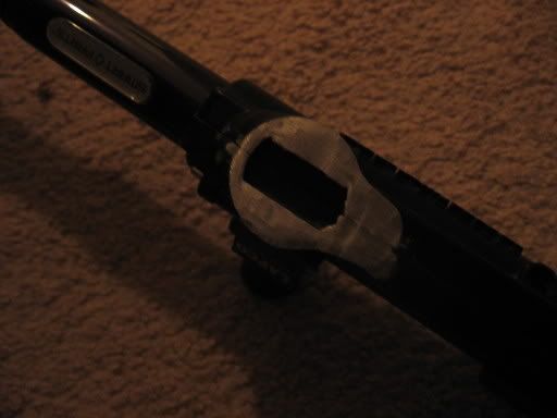

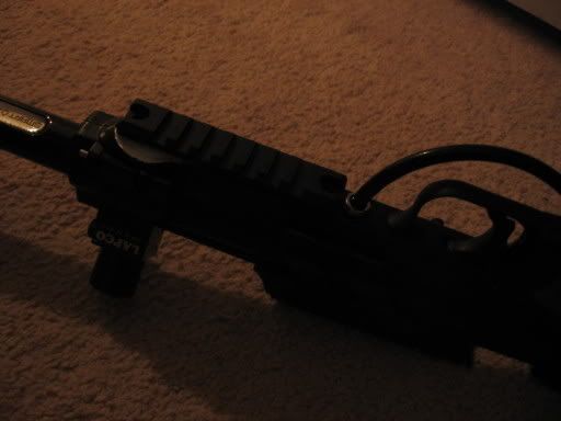

ok... I've run myself into a problem... The top hole for the rail needs to be tapped right into the middle of the hole... :wacko: Now I know I need to fill this hole with something that will not bind the 2 halves of my marker together, and something I can thread a screw into. I was thinking Bondo... but I'm not entirely sure.
Here are the pics
^ as you can see the hole in the 98c is right where the bolt fastens the rail tightly to its component. (This is right next to where it is on the marker to show the problem I'm having.)
Please list solutions for this ASAP. Thanks!
-Gun

#60 User is offline   questionful
  • AGD Freak
  • Posts: 2,621
  • Joined: 23-June 05
  • Location:SF Bay Area, California
  • Brigade Name:QUESTIONFUL
Posted 13 March 2006 - 04:31 PM
Eureka!
Okay. So, light a candle. take some of the melted wax and rub it on the inside of one reciever half. Actually, forget wax, use like. . . vaseline, or any kind of lube or oil or whatever. Then, use a putty (is J&B Weld a putty?) that bonds with metal and put it all over both reciaver halfs in the vicinity of the hole ( rubbing lube inside the hole with your finger. :) OMFG). Let it dry or whatever it does. Then the reciever half with the lube should come off, and the other half will have a block that fits perfectly and can be tapped.
