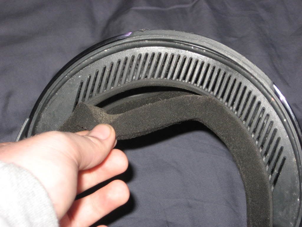

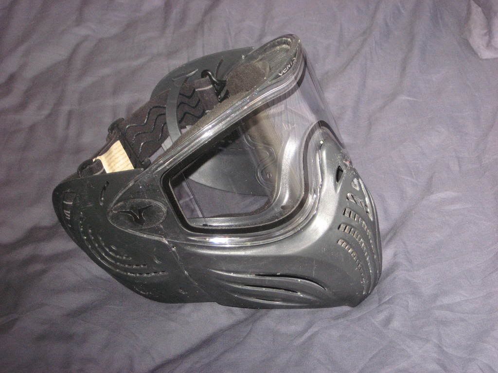

I love this mask. it the first generation of the E-Vents.keep in mind i dont want to buy a new mask. the cushion on the top is coming off. Ive already tried to tape it down with duct tape(the best man tool) it eventually gave way. HOW DO I FIX IT??

use superglue or two-part epoxy made for plastic/rubber/foam

Hot glue will work very well.

i tried hot glue on one of my masks and it came off
ive tryed super glue on older mask and it left a clump of glue that botherd me so got this mask

double sided tape? i have the same mask....i love it lol

Contact adhesive, rubber cement...

I would just try gorilla glue, carefully applied of course.

use a little sand paper on the inside plastic first, give the glue something to grab onto in the bond.

will the glue harden up and be a big clump?

not if you just put on a thin coat and apply it correctly

like everyone else said, you want to use a fine grit sandpaper(ide use 200 grit) and lightly sand the surface, then ide clean the surface with some rubbing alcohol...once that dries, apply a thin layer of rubber cement to both surfaces(the foam and the plastic) but dont let them touch just yet....give that an hour or two to dry...then apply another thin layer to both surfaces and hold them together for several min. until the glue begins to set up....then let the glue cure for 24Hrs and you should be all set.

ok that sounds like it will work ill try right now
