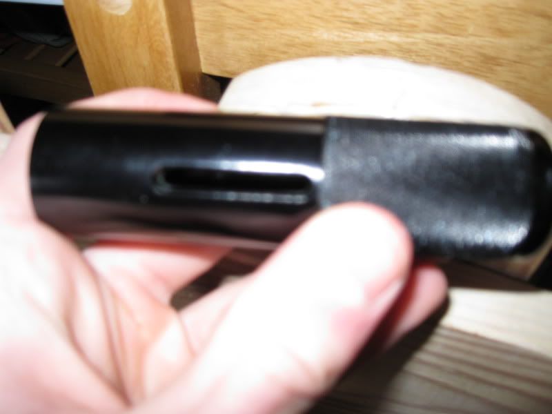

After months of being lazy and just using a 3.5oz because it didn't leak, i decided to find the leak on the 12g changer. Its coming out of the little slots in the holder itself (see picture below)
What do i do to fix that?!?

If the 12g is leaking, you need to check the puncture seal. You could be missing a small o-ring there.
What kind of 12g are you using? It's possible that the 12g is a bit too short to get a proper seal. you could also try adding an o-ring into the bottom of the changer.

just figured it out actually by going to CCI's site, and looking at the parts list. I'm missing the puncture seal thats supposed to be surrounding the puncture needle. The guy at my local store is making a special order soon and he added that to the list for me. Woohoo haha
