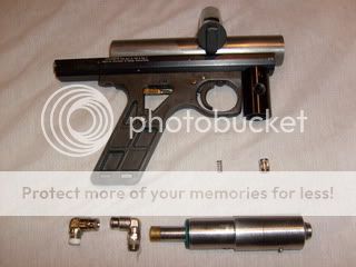

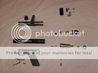

Update - 11-19-2009 - I've picked it apart a little bit. In the upper right are the macroline fittings, vertical ASA (not sure if I'll use either of these) and two unidentified parts. I would appreciate any help with those. As far as I can tell the body is in okay condition, useable. The rail is in good condition. The trigger frame/assembly is in good condition and all is useable. I don't really know all that much about 'Mags so I'm kind of screwed until I watch the videos. I tore down the regulator and the valve as far as I could. I have no idea if they're missing parts or if I haven't torn them down all the way or what. Obviously I'm missing a few pieces. The bolt, a barrel, a new ASA, and grips. I don't know if I'm missing more, if you see anything else feel free to tell me. Any and all input and help is appreciated!
