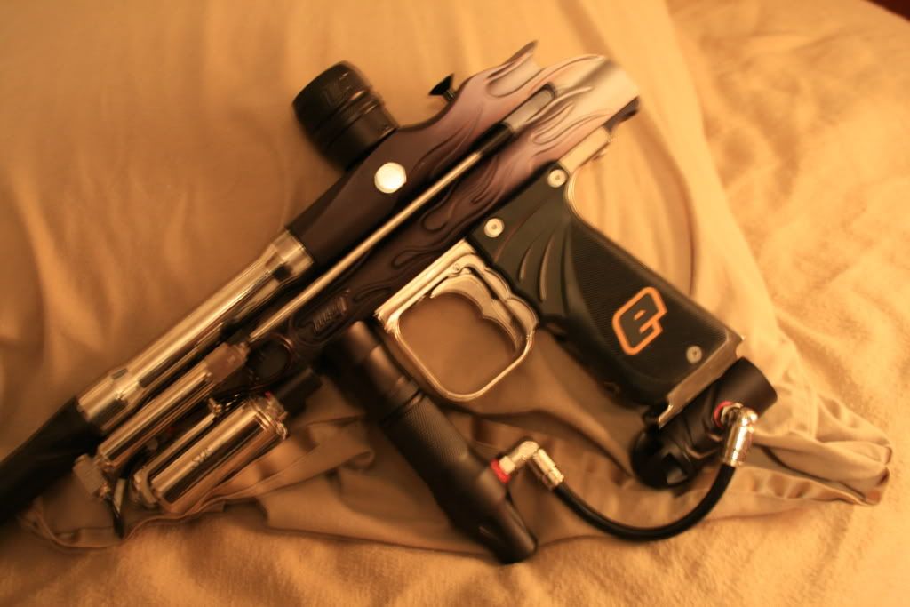

Select Fire board has semi, full auto and ramp mode. BPS is not adjustable ~ nor is any timing setting. IMO the SF frame is good for those that don't like to tinker but a swap to E1 or E2 is a must for maximum performance, field regulations, and overall feel (I hated the SF trigger).
The SF frame can be modified to house E1 or E2 board but it would take a lot of patience and dedication to get the holes/screen cutout correct.
The SF frame does use the same 5-way pnumatics noid and reflective eye though as E1 or E2 boards so a frame/board swap is easy.
Here's a picture of my 05 Black Magic with E1 frame swapped:

UMP ~ your BM and mine are twins as I've since added freeflow front ram and LPR in nickel along with the noid cover since I took that picture back in December.
