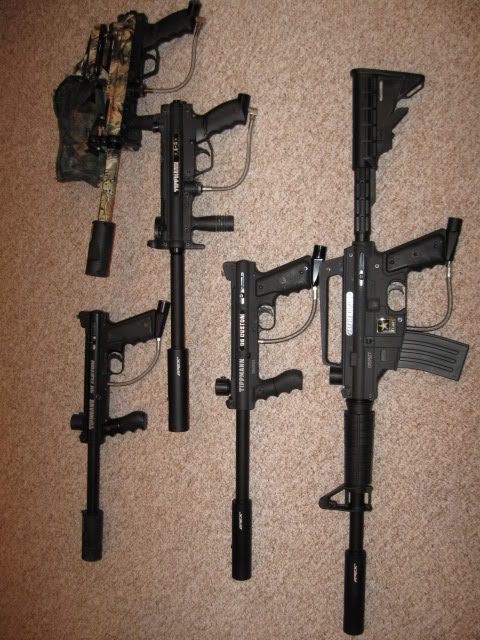

I like my paintball gun short, which was one of the things I really liked about the original Apex barrel; it gave you the accuracy of a longer barrel, without the added length. This new Apex 2 barrel is available in 2 sizes. The smaller size 14 inches (once installed on my A-5 with the quick connect adapter) is 13 ¼ long. The original Apex was only 10 inches long. (Measuring from where it protrudes from the receiver body to the end of the tip) It is longer if you figure the threads…
A-5 with apex on top, A-5 with Apex 2 14 inch middle, and Apex 2 18 inch (98 custom threads) on bottom
Or you can go with the 18 inch Apex 2, which installed is a little over 17 inches long.

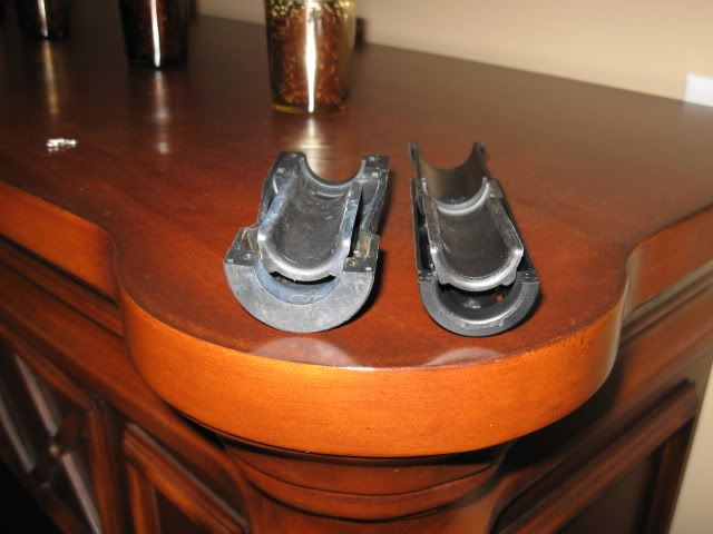

At the top of this picture is the original Apex disassembled, and below is the Apex 2 disassembled.
So as you can see they have made some changes, most noticeable is that the rubber tip goes further under the barrel, which I would assume makes the ramp more stable when adjusted all the way up or fully ramped. The biggest engineering change is the ramp adjuster which now is attached at the tip and acts as a button. So when you adjust the tip, it does move. Which if you are adjusting while firing would change the ramp amount dramatically I would guess, and I can’t wait to see if that is true… (I will update this thread once I shoot a video test)
I read that someone said they were getting a lot longer distance with the Apex 2 than their Apex 1 so the first thing I did when I got it apart was to compare the amount of ramp that level 9 achieves on each. And I took pictures so you could see the difference as well.
So the Apex 2 does have quite a bit more ramp!... Meaning even longer distance targets are now within your reach. I have already proved that you can hit guys over 350 feet away with an Apex, I can’t wait to play with the Apex 2.
The “threads” on the Apex 2 tip are different than the original, But, they are close enough that they should work once you remove the o-rings. The first indentation into the barrel is smaller than the previous Apex tip, but I took my original Apex 1 barrel, and put the Apex 2 tip on it and it fits fine.

First off a Tippmann 98 Custom top marker has the 14 inch barrel, and bottom marker has the 18 inch barrel. The stock barrel and original Apex are in the middle for comparison.
And I can’t forget the newbies that want to get into paintball and their mom picked them up an Alpha Black for Christmas. You want the 18 inch with 98 custom threads for your marker. If you buy the shorter 14 inch you will have to remove your barrel shroud for it to fit.
18 inch Apex 2 on an Alpha Black Tactical
14 inch Apex 2 on an Alpha Black Tactical with barrel shroud removed
And a group shot for fun.
