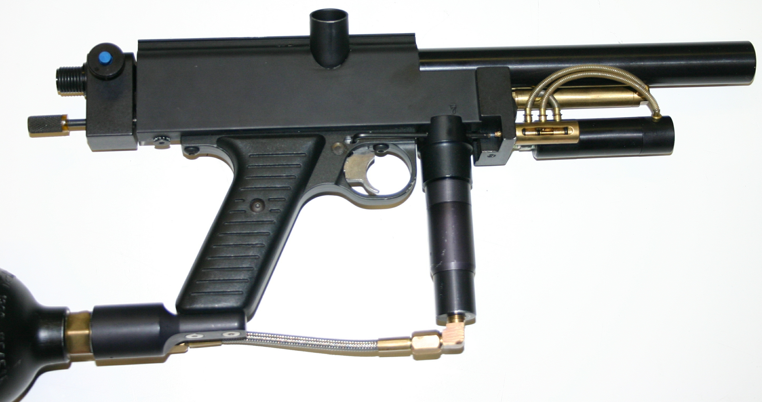

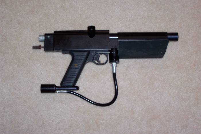

This is an Autococker:
Same marker with the housing removed:
Short version: It's a semi automatic paintball marker.
What makes them "bad" is that people who have no clue what they are doing will try to re-time it and screw it up. read this to learn more: http://www.endlesspb...ech/timing.html
Other than that is all just personal choice.
Snipers aren't made anymore. WGP was bought out by Kee (I think) and they stopped making them. Instead they made 3 versions of an updated Autococker. Snipers are now more of a custom thing. You can buy a kit that can convert the Autococker into a Sniper.

So basically, an auto cocker is an automated pump...Interesting. I read some more stuff about them. They seem to not be overly-complex, but just enough to where if you move the wrong thing it can mess the entire marker up, like when fine-tuning everything to your likes.
How hard would it be to convert a cocker to a sniper? You would need to remove the front..things, right? (i don't know what those things are, the things under the housing in puzumas pictures above. something to do with the pneumatics i'm presuming.) Then there's something to hook the pump up to, correct? But after you add the pump kit, would you need to re-adjust the other parts of the gun? (I think that is what would turn me away from using a sniper/cocker, all the adjusting you need to do.)

To remove the front pneumatics is fairly straight forward. in Puzuma's second picture of the Autococker you see how the 3 way ( which is technically a 4 way, but lets not get into that) is attached to a little block, which is then attached to the frame of the marker.
Yup you guessed it, Remove the entire block vie screws. And replace with a pump. Not exactly hard. And because your Hand becomes the pumping of it, there is no technical timing to fiddle with, just pull back. put the pump back in the forward position, and shoot.
