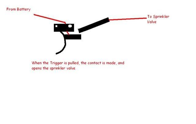

I need some help building my launcher, How would I make it fire using a trigger system, primarly a tippmann gripframe. It needs to be like this for a game I will be playing called Tippmann World Challenge, which I do believe only allows tippmann markers, and if it has a tippmann trigger, it will be considerd ones. I just want it to be trigger fired system anyways. Let me know what you got. Thanks alot guys

Is it going to be a basic low pressure (about 100PSI) launcher? If so, just make the trigger into a contact switch. Pulling on the trigger closes the circuit. The electricity opens the sprinkler valve firing the launcher. Its easy to make and simple.

Some detailed instructions would be nice. What about a valve at higher pressures.

some people use a sprinkler valve rated for 150 psi with three nine volt batteries and a momentary switch, still others use a sprinkler valve and mod it to fire faster and more effecient with a blow gun either one can easily be hidden inside a gripframe. and regardless of what frame you use it will still be considered a launcher. the game you are talking, about all that matters is what marker you use, not the launcher. to put either switch in a gripframe simply hollow it out , drill the apropiate hole, install triggering device and use clamps to mount frame to the laucher.

Simple picture:
For higher pressures you would need to make the launcher out of steel not PVC. High pressure launchers are usually around 800PSI. With a PVC launcher, 100PSI is the maximum recommended. With the high pressure launchers, ball valves need to be used. To use a trigger frame with a ball valve, its a little more complex but basically you need a spring loaded valve and when the trigger is pulled, the latch holding the valve closed is released and the valve opens.

Thanks everybody, I'll look into the spring powered ball valve. Can you draw up a quick diagram if you guy s have time, thanks alot.

It can be built many different ways but basically:
The ball valve handle has a small pin locking it open
Attached to the end of the handle of the ball valve and a firm mount, a spring is stretched between
Attached to the trigger and handle locking pin is a string or line
When the trigger is pulled, the pin is pulled out releasing the valve handle, and the spring opens the valve.
