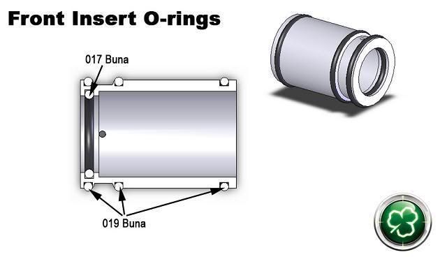

Stage 5.1 Orings -
Front insert
17 Buna (internal)
19 Buna x 3 (external)

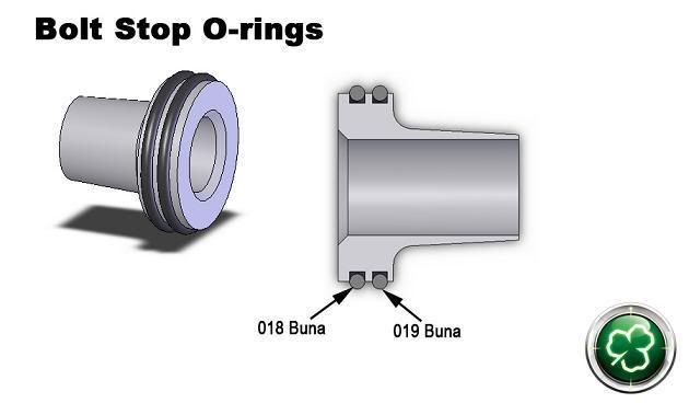

Top Hat - from front to back
18 Buna
19 Buna

I gangstered this from Nation. Credit goes to ziggeymarley for putting it all together...
http://www.pbnation....d.php?t=2111150
