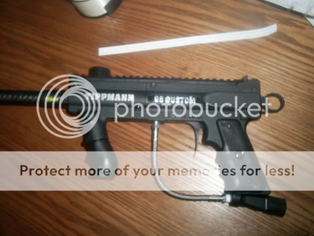

Here are some pics
My gun has the techt trigger upgrade,stiffi barrel, and BT closed bolt
