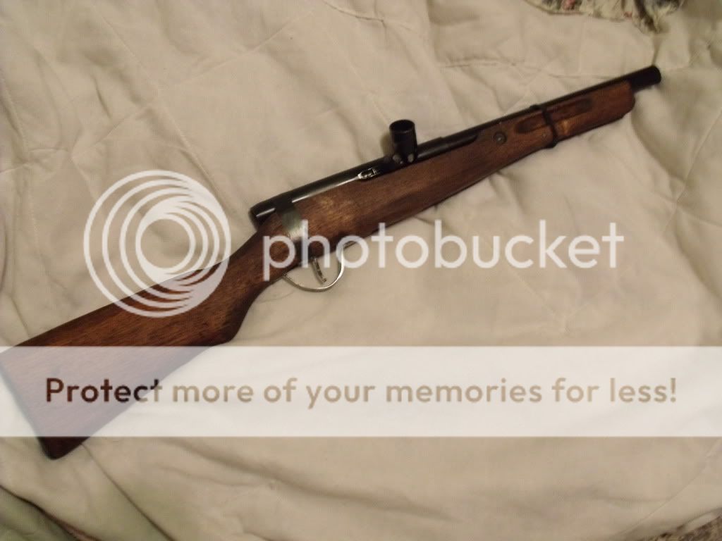

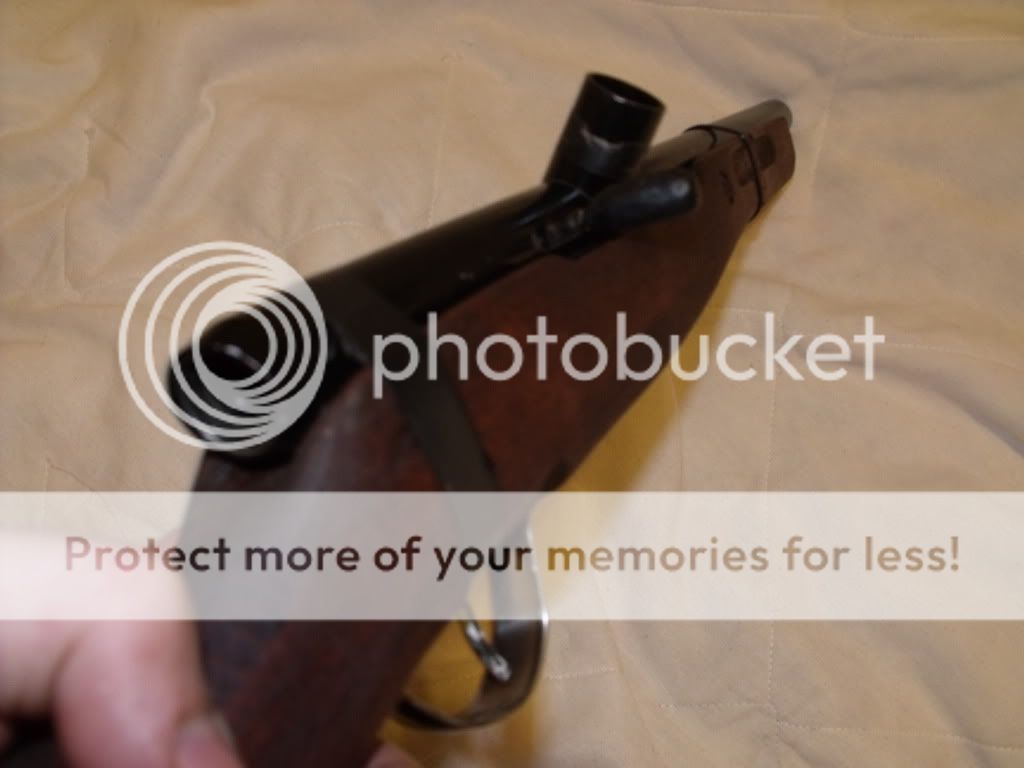

my bolt action trracer project!
i am just waiting on the air lines and stuff and its complete
pics
im gonna figure out a way of mounting it in the stock so i wont need electrical tape

Looks REALLY good! When I built mine, I drilled holes to match up with the frame bolt holes in the marker. I needed to use longer bolts to reach through the stock, but it has held up pretty well.

very nice, where did you get the stock?

i got the stock from a local gunshop, it was for a SKS
only costed me $20

Looks nice! Couple pieces of advice:
Drill a hole through the stock to meet the front frame screw, then use a longer screw to hold it in place.
For the air routing, you can use Phantom valve parts, just use the Trracer guts. You could get the vertical air valve (with the hole on the side) and run a line to an ASA or remote or bucketchanger somewhere.

finally got around to uploading pics of a scenioro i went to on the 4th of october, lol 2 week to late. well heres a pic of the bolt action traccer completed and on a stand. i got so many complements and a couple "wtf is that?" comments
